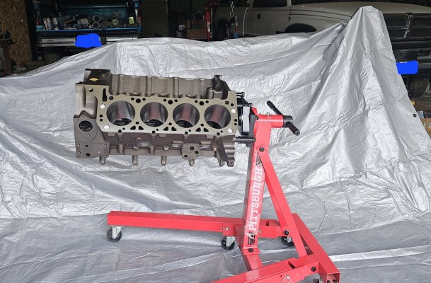

Yesterday I did the most "I don't wanna" thing I have done in awhile. My brain thought it was absurd but, the machinist said to do, I power washed my freshly machined motor block with Dawn in the soap despenser.

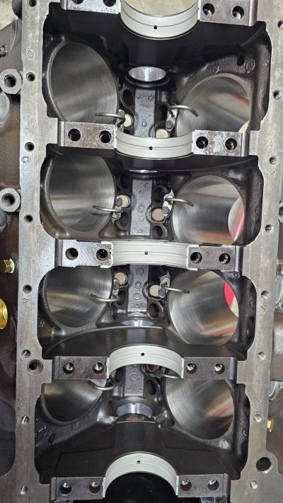

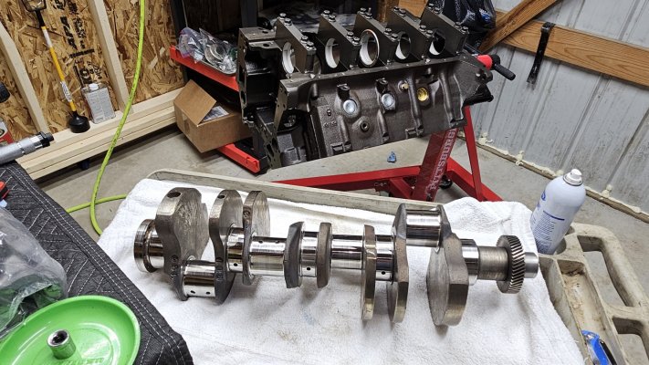

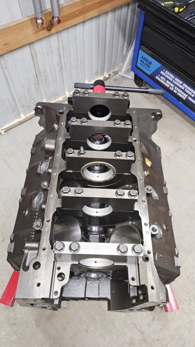

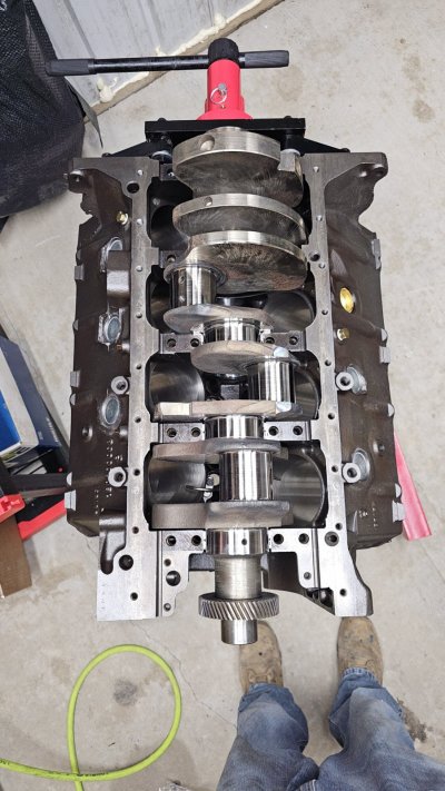

Between yesterday and today I cleaned and installed the piston oil jets, the main bearings and the crank shaft

It looks like it could have some life in it after all. It feels smooth. Time will tell. That's all for tonight from me other than this, it was all I could do to accept that the piston oil jet bolt torque to only 7 ft/pounds. I had to go buy a new torque wrench to go that low and resist the urge to go way tighter . I did put the orange lock tite on the bolt for my peace of mind.
