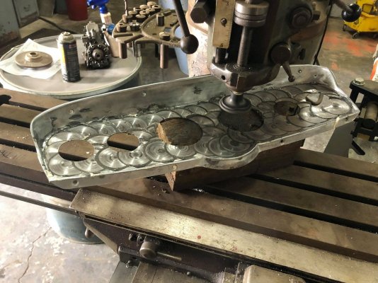

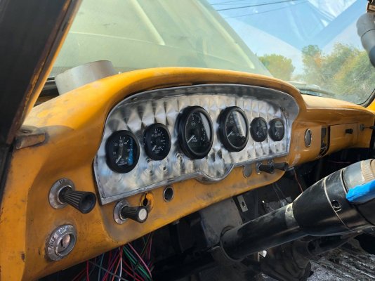

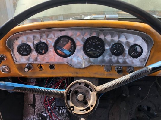

today was nothing but wiring. got most of the circuits ran, but still gotta connect them.
all 2/0 battery cables are done and we got to jump the starter wire to hear it go reer reer reer.
needed to hear some progress LOL
also didnt really care for the gauge cluster the way it was, so....
i spruced it up a little with help from the ole bridgeport!

I did something similar using one of those foam headlight restoration pads and some lapping compound. Looked pretty sharp, but the shine made it hard to read the gauges, so it was painted over.
