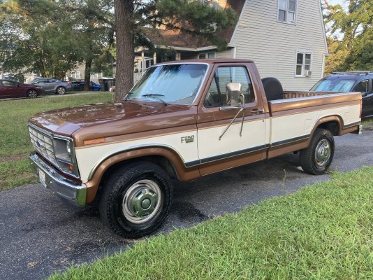

Finally got around to washing the ol’ chariot today
