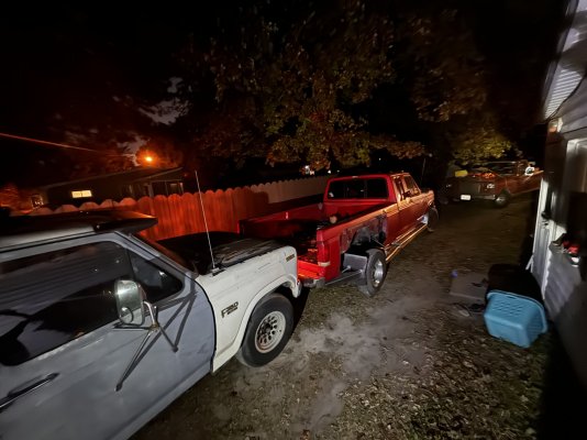

Found a 500 spare parts truck with a (mostly complete) banks sidewinder turbo kit that I intend to swap to my 7.3 this weekend. This red truck’s Motor is locked up - crankshaft won’t budge clockwise
And the money shot
appears to be missing the oil feed supply.
I don’t see a way that oil is connected to the driver side rear of the block.
Another thread said just call Banks for the missing oil feed parts but I don’t have $100 to my name at the moment, but I do have $30 and a local hardware store
More to come stay tuned

I will search forum after posting this request but is anyone willing to share a photo of their banks sidewinder set up? Theres a bundle in this photo which is missing 2 things

That looks like the latest banks kit, nice find! The sarcasm in me has to ask, does the engine bar over counter clockwise?
As for the oil feed, its just a generic braided line. Any line should work as long as its rated for oil and about 100psi
Also check, oil feed may come from the oil pressure sender area. You can see on top of the turbo bearing housing a line going back towards the firewall.
Also, did it come with a free wheel socket?

I found where the oil supply comes from - there’s a port (not by the CDR) on the bottom rear of the block. Looks like everything is mostly here, just missing the 2 things on the bundle.
Yep, free socket lol.

Motor is mostly out, but pausing to remove the fan so it doesn’t get crushed
