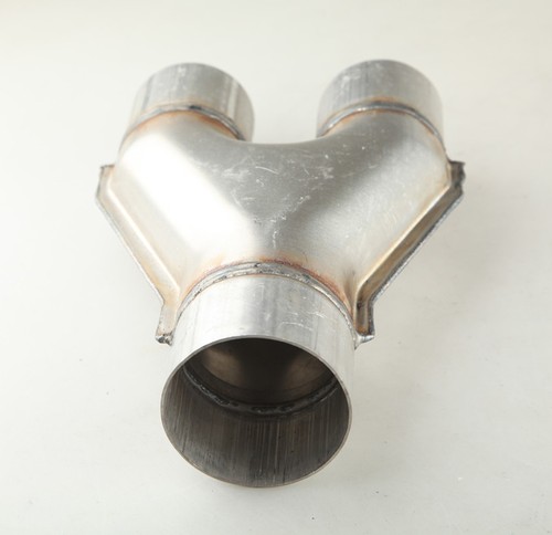

If you want to make that muffler work, you can get this and have two smaller pipes too send out both sides.
I know the inlet is small but that was all I can find. This is what I can find to make it right size, stamp the 4in side into a oval that can be welded to the 3in side of that y.
