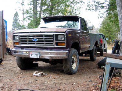

I recently picked myself up another diesel truck... I'd been suffering some serious withdrawl(sold my last one in Febuary.)
Anyhow, it's definatley a project. 86 F250 reg cab 4x4 XLT Lariat, 6.9/4 speed, body is in sad shape, and it hadn't been plated since 2000, so at least 5 years without running, possibly more.
Got it running(albeit not very great) last week and started tearing it down on the weekend
Underhood and in the cab, the truck was completley 100% stock, not a wire cut, and everything was 100% functional other than one burned out clearance light bulb. It's a fairly well optioned XLT Lariat, and most of that is going to get transfered over to the new body.
I finished pulling the dash and electrical system out of it last night, changed the IP out this morning(runs waaaay better, even tho it's a 7.3 pump with unknown mileage) Still needs injectors and glows tho(one of them still works... LOL) I plan on switching it over to 12V glows.

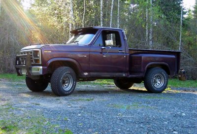

As for the new body, well, I have this 81 F100 FlareSide kicking around that I haven't quite been sure what to do with, I dumped a bunch of money into it, the the engine took a turn for the worse and the frame broke...
I was going to pull the body off of my other F250, but, I may as well use the one that needs a chassis...
I'm debating shortening the frame and using the FlareSide bed, would look cool with Lil Red Truck style stacks, but, the bed is a bit impractical in size for something that will be used as a tow rig.
Anyhow, any advice on injectors? It currently has the factory Italian built units in there, and I have no clue whatsoever what code they are. I'm debating going all 7.3 spec on the fuel system. I know I'll be needing a pyro with that pump installed, but, I'm also thinking turbo once this project is less build and more drive.

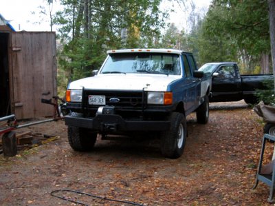

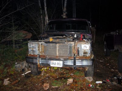

Well, time for a bit of an update, have the body completly off of the diesel, and the other cab sitting on 2x8's between the frames as of tonite, have to blast some holes for the diesel/A/C wiring harness, clutch(donor was linkage clutch) and put on the firewall insulation before I plant it in it's new home, but, it's slowly getting there. I'm probably going to do a 1 or 2" body lift while I'm at it, just to make it easier to work on, my buddy's 88 crew has one, and it's soooooo much easier to work on it.
Anyhow, here's some pics from yesterday.
Last pic is my buddy John's 88 F350, another major project... Believe it or not, it's only got about 60K miles on it, about 10K of it on a 6.9 conversion, truck came out of the factory with a fuellie 460 and ZF, now has an 85 6.9, and ZF from a 90. He's got most of the major stuff done, so, body and paint is on the list for sometime soon.
