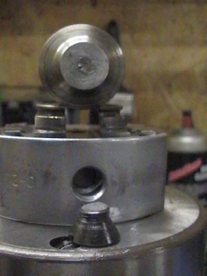

I would say that **** mechanic is one of those people that gives a diesel a bad name, by making a smoker. If he knew what he was doing, it would have run like a **** better backing the fuel off. Ya, you can make em smoke by also setting the timing retarded. Could be he's a little retarded. Cranking the fuel up can result in something like this below. A sheared drive shaft, a junk IP, and a big lightening of the wallet.

342
Hey, that looks like my two month old DieselCare IP! Did you nab that from the floor board of my 250?
I haven't been to Kalamazoo for a long time, last time I was there was in 1943.;Really That's what ya get when cranked up a little too much :eek:

342
The sad part, is it wasn't turned up at all; I actually turned it down about two full turns to get it to stop smoking.
Not saying this is what happened, but very well could have been.
That's possibly where things went wrong. Could be that your timing was/is way off (retarded), it will smoke like crazy then. Two turns, hope you mean backed out and not down (in). That screw is very short, and the tension (fuel setting ) is done on a very expensive test stand, one or two hex flats IN, can make a big difference. That screw is very "tight" to turn, backing out that much could have loosened all the tension on the C ring and rollers causing it to jam and shear the shaft. Pic shows the C ring and rollers and broken drive shaft settin on top.

342
Sounds like you done it the right way. That broke IP was from a member that was 2000 miles from home. :eek: :puke:. Gets awfull expensive when something like that happens.
