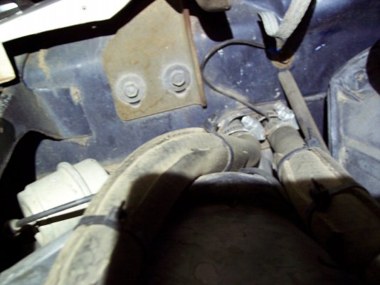

You might be suffering from electrolysis for some reason.
I remember someone on here saying that these aluminum heater cores do suffer from this. The stated solution is to run a ground wire to the heater core. This is how I did mine. It's kind of hard to see with it being a little blurry and shadows because it's night time in this picture. I made a ground wire that I attached to the firewall with a sheet metal screw. On the other end, I just used an extra hose clamp to hold the end if the wire against one of the hose fittings on the heater core.
