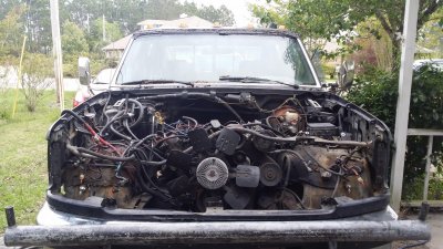

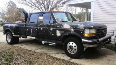

So i came to a conclusion that i should go ahead and rebuild the IDI. it has coolant loss, oil leaks, etc. I got the truck running again and drove it maybe 30 miles total every since i had it maybe 5 months now. It ran strong but problems started showing up. Where can i find the gasket kits for the turbo engine? I searched on google (im a search freak) and cannot find anything. Every link that i find says Non turbo. I did find one though called falcon global on ebay for gaskets and other parts. Is this the go to company for IDI rebuild parts? What should i be on the look out for when taking apart/ rebuilding the motor? Cavitation should be the first thing i suppose. i would really like to make this $1000 dually a long trip hauler without any problems. Truck is young with only 183,***. Thanks.
