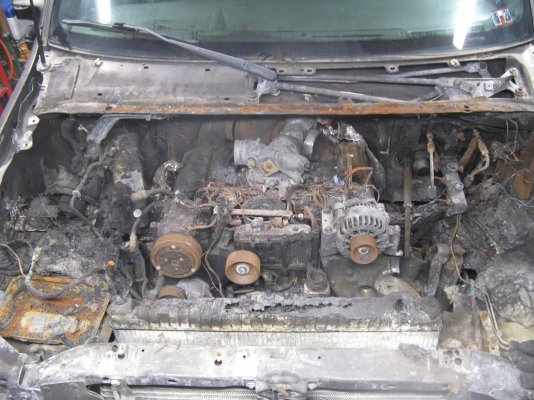

Last underhood pics of before and after. Still a few things I need to do however it's time to get to work on the leveling kit and installing those wheels and tires. Been a long haul however It's getting close to a road test!
