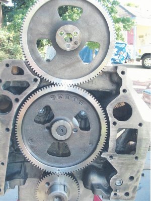

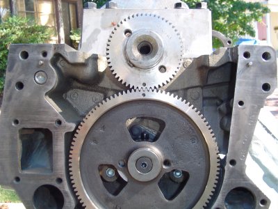

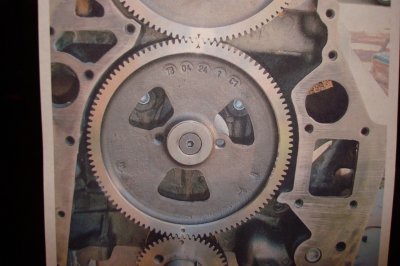

With the front gear plate removed its simple to line up the gear timing marks. It can be impossible if the plate is on the engine. The cam gear is about half the injection pump gear below the top of the plate. Heres a good pic of the gears and timing marks.
