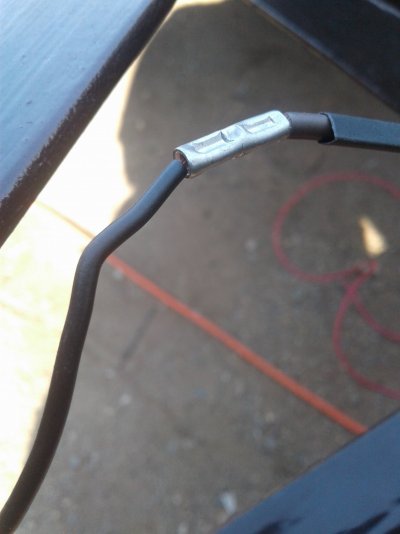

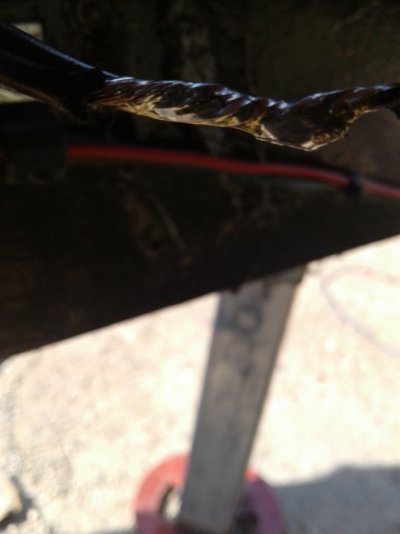

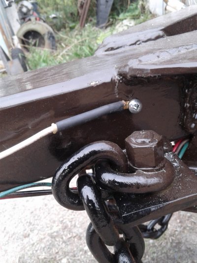

The trailer i built in Sept, the wiring was all crimped metal connectors,save he 3 wire connections which were soldered, heat shrinked all connections, and wrapped with electricl tape. Thats a good point. Keep them dry

Another issue with solder and the primary reason why I recommend people use mechanical crimp joints when doing electrical anywhere outside the cab. Solder has a major tendency to attract moisture and propagate corrosion. Probably yet another factor that contributes to the failure of soldered copper/brass radiators.
Wow this is news to me. I always thought I was going the extra mile by soldering, and never thought to research whether crimping is better. After some googling (not that I don’t trust you) you’re 100% right. I’m always learning new stuff on this forum, thanks!

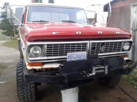

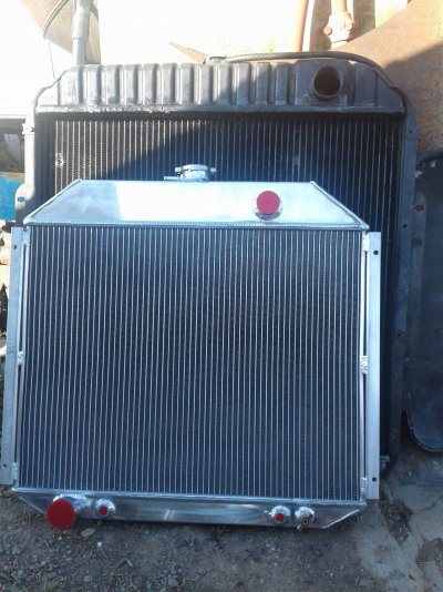

If i was using an original Diesel Ford, id stay with the factory radiator. But, this 1970 ford, has been upgraded and custom built. I have seen the mods needed for that radiator fitted in my narrow framed truck, but notching the frame, to do it, isnt an option for me right now. ive had this idi diesel in this truck since 2003, and the 6.9, was replaced with the 7.3 round 2005. The factory rad rebuilt in 2012, so, many firsts.

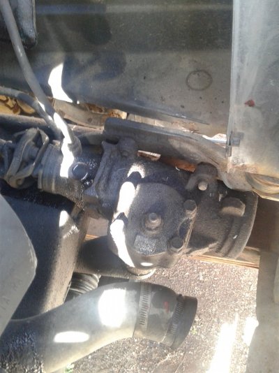

Im running a 73 Buick Centurian steeing box, and cross over steering, makes for a tight fit for the bottom of the radiator. This new ra idea, makes for aa better fit. And, a 3 core, is supplying enough volume for what i use this truck for. Ill add an extra volume tank if needing more volume. And front mounted electric fans if neeed. See he notch, i had done years back, trying to get away from that as well.
Thats awesome! I get all warm and fuzzy when I am actually useful to someone. There are solders that prevent that feature, usually high silver content used with specific types of flux but its not the kind of stuff found at normal stores. A good crimp tool with a sleeve of heat shrink and maybe a dab of liquid tape to seal it in is usually more than sufficient.

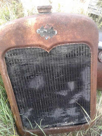

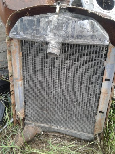

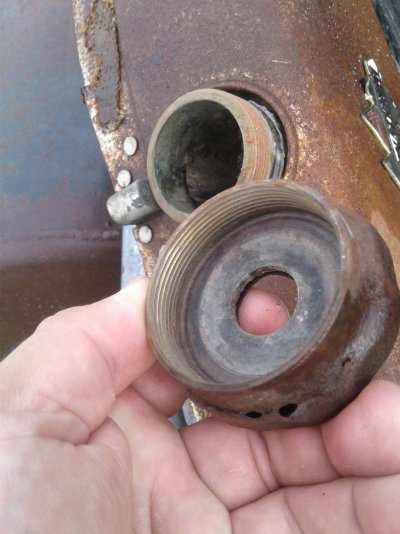

Heres an oldylate 30's IH, notice the brass fine threaded cap big tubes and lots of solder. Silver solder no doubt.

Biting the bullit on this , and ordered an Aluminum Radiator, a Champian brand. Ordered it yesterday. My 1970 F-350 has used a brass rad for years but, the last repair didnt take well. Upper tank leaking at the seam. Rad shops around here , a canadian border town arent always up to the task, or, cost a lot. For 305$ US shipped, i cant do better here getting it rebuilt. Its a 3 core i ordered. Im running a 7.3, idi, but still believe this will handle the cooling I need. And, i can add fans if needed. Im using the factory clutch fan, which pulls a lot of air.
Just remember to check the radiator cap of the the new radiator. Mine was overheating like hell til realized the new cap was 18 pounds and mine ran a 12 pound!

I will thanks. Its supposed to have a 13 pound cap. A 16 lb cap is typical for an 83-94 diesel, by the way. Also, for my installation an overflow bottle

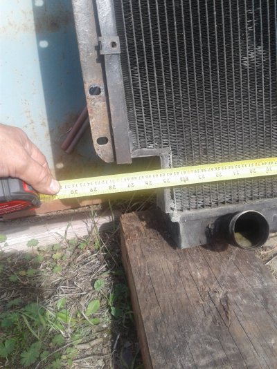

I ordered the wrong radiator so its on its way back. I ordered a cc395, instead of a cc433. A result of to many tabs open, anxiety of using my left side of my brain, and just plane age. to small, width wise especially. I ordered a 3 core, minium. to make up for being 5 inches shorter than my old rad. once im credited, ill re order. It happens
