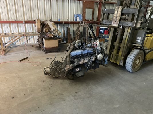

Pulling the engine and trans today
Laine D
Jan 23, 2019
1,362
1,945
Northern California
Took us 3 hours. Was kinda a pain because there was a lot of bent up ****. I did notice (I don’t know if I should be worried, as of now I’m not really) that my “new” frame is about an inch wider at the front horns. I mean an inch wider than the bumper holes on my truck. So I’m assuming they rear ended something at some point. I’m not really tripping about it. All the suspension is behind that, I’m definitely going to be pissed if this Thing ends up crabwalking
