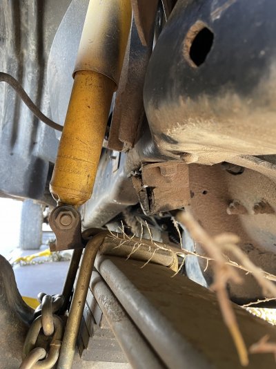

Got my baby. Cab isn’t near as bad as I thought. I can definitely fix it. I’ll need a frame, it stretched super bad at the driver bump stop and has cracks all over it.
I’m so happy to have it back and I feel so much better about fixing it. I got a line on a frame, I bought axles from a 2003 f350! SUPER excited.
I know it’s not fantastic circumstances but I’m very excited to fix my truck, even if it takes me a year. I’m prepared to do it right, I’m prepared to not drive this for a long time.

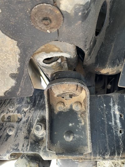

Some photos

Now I don’t know if I should Be putting these on the internet but anyways. The cab is kinda beat up but I already hammered a lot of it back. The frame is bent in such a weird way that the body mounts are all crooked on one side. But the cab part of it is good. So I won’t have to cut and weld much, it not anything. The dash and all the interior is still super solid so that tells me I didn’t break any of the mounts. Didn’t rip up and wires or anything. The frame is just really tweaked. But I’m surprised the body isn’t worse.
Sometime this month I’m going to grab a frame and clean it up. At that point I’m just going to run all new fuel lines and make my filter setup way more pretty.
The guy that helped me had a bunch of scrapped out trucks and gave me a t19 with a 1345 case so that was extremely nice. I don’t really need it but I feel like the t19 can be traded for something. Plus it looks to have been opened up and resealed recently so maybe it’s got some work done.

Thanks for the pics, I was expecting the frame to be worse based on how twisted it looked in your photo at the accident scene. Glad you are on the way to repairing it.

yeah it really doesnt look too bad. As has been mentioned, these frames flex A LOT! there are times when parking at a jobsite, that my doors rub on the front fenders when opening and closing. as soon as I park on level ground the gaps are fine again. I have a utility bed so I can really see it, but try and watch your bed as you go down the highway. it can move an inch or more out of line with the cab just cruising.
