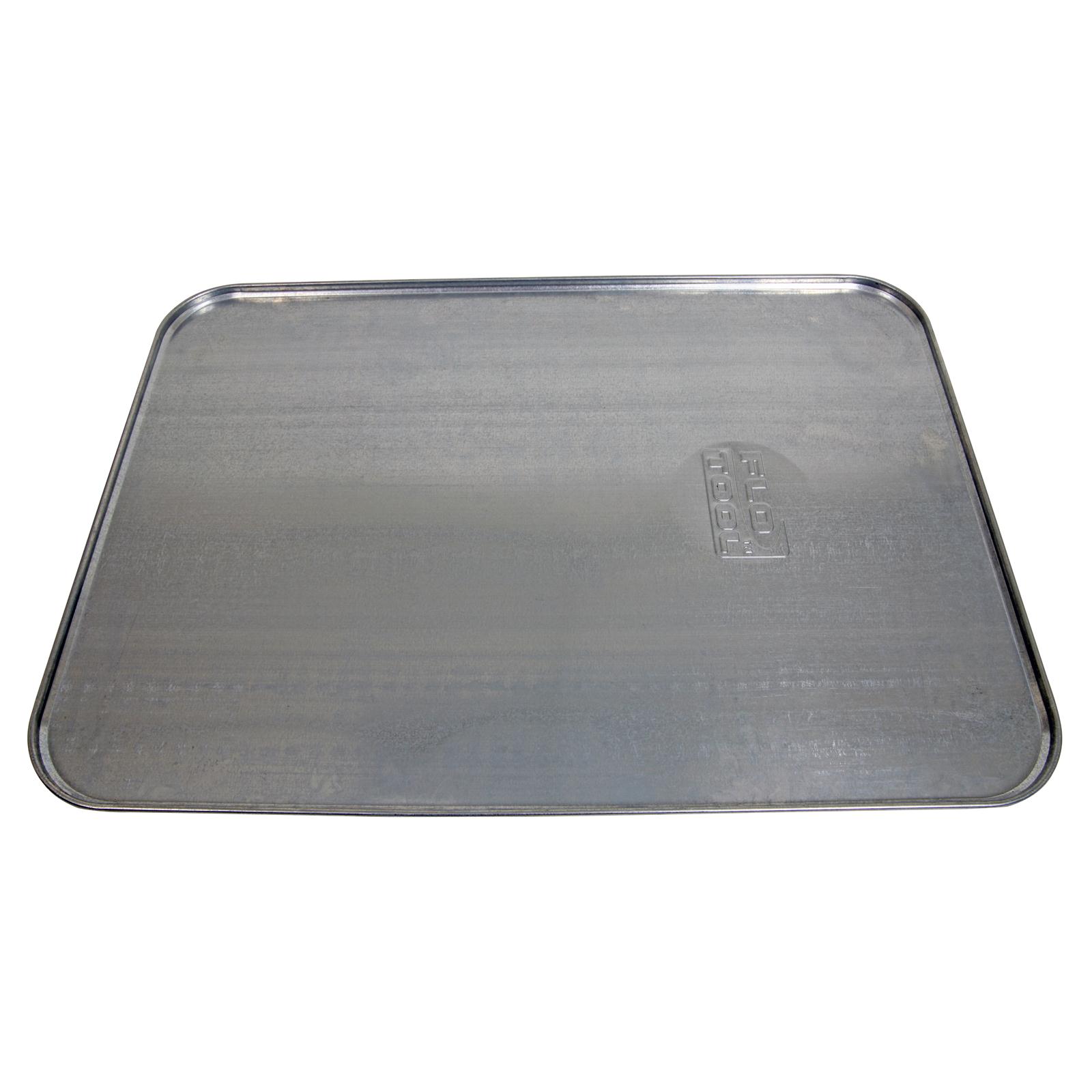

Since you are familiar with the Summit website...something like this will keep your shop floor cleaner when you go to re-assemble the engine...
I have a similar one and it is much appreciated....I plan on building an engine once I set up a building to do it in..

@XOLATEM You're very welcome! And good idea about a drip pan.
