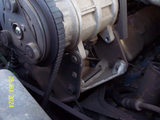

My 89 had factory air (at least I'm pretty sure it does since everything looks stock inside the cab). Here's the compressor bracket before I started taking it all apart:
Looking at the replacement engine I picked up, I to see the compressor bracket arrangement is different:

I haven't seen either one of your two bracket set ups. This is the V belt set up that I've seen on trucks with A/C.
I’ll have to put a picture of mine on here sometime…
