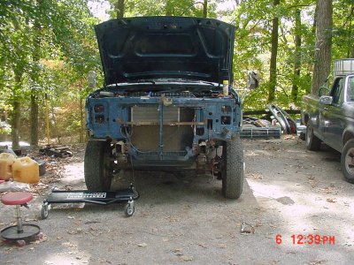

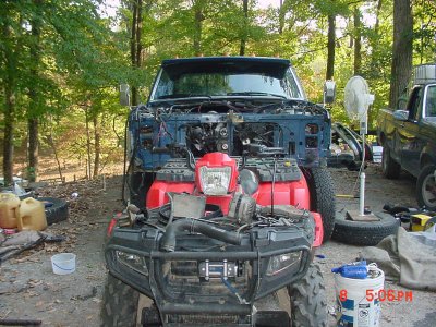

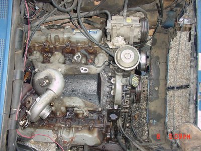

Hey guys! I finally got some time to start taking my truck apart for some much needed R&R. So far I've planned on new injectors, moose pump( Mel check your PM), glow plugs, ATS turbo upgrades, 5" exhaust pipe, exhaust brake, intercooler, aluminum radiator (RLDSL check your PM), thermostat, water pump, electric fuel pump, coolant filter, and oil cooler o-rings. If anyone thinks for something else that might need replaced I'd appricate it. I have a few pictures and will continue to take more untill it's done.

I was going to take some more pics after taking the ip come off but it got dark too fast. I've been having problems with trying to get the turbo off. I can't get the bolts that hold it to the up pipe to break loose-cuss ;Pissed . I guess I will keep spraying it with the penetrating oil untill it comes off.
6 Nebraska IDIs
May 27, 2007
4,247
if you have a bernzomatic bottle propane torch, heat them little buggers up. They'll come off then!
Try some Map gas instead of propane. It burns hotter. OldMrBill taught me that one. Sure enough it works way better.
374
I'll be real interested to see how your numbers are after all those mods! Keep in mind the intercooler will bring your boost down a pound or two, but the boost that remains will be much more dense, so there is still more air for fuel to burn.
