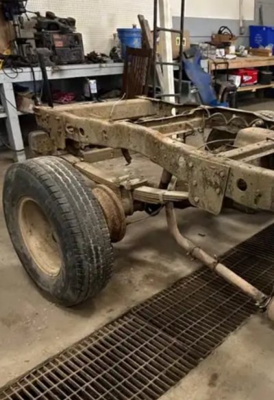

Stumbled on an example of what would be involved to put a C&C axle in a pickup...
4,209
4,793
Oh dang that frame really is pinched together there in the middle... Thanks for the photo

I dont think the frame itself is modified. Its the flat plate hangers... to get the spring spacing.
