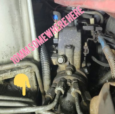

Started taking out the IP from my bus. It's blocking the office trailer in my yard that my dad wants to take. If I can get bus running it would be way easier than winching it around all these corners!
I dropped my 10mm into the valley pan when taking off the throttle bracket and that was a good stopping point haha
