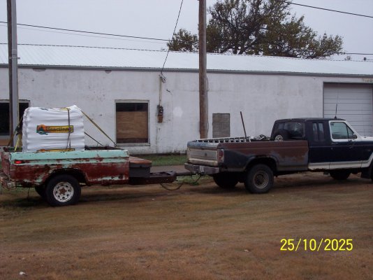

This morning, I left early to help friends bring their wood pellets home for their stove. It didn't help since the fog was so thick that I could only drive about 50 MPH. A few minutes later, it was light enough that I could actually see a little bit, but at 7:45 when I left, there was just a glow in the sky. After getting the pallet of pellets loaded, I stopped off and got hair cut before hauling the pellets to their house. Unloading was almost as easy as the loading was. The store used a forklift, he borrowed a neighbor's skid steer with forks on it. I had no trouble keeping highway speed for the 18 miles trip to his house since there wasn't much wind blowing.
