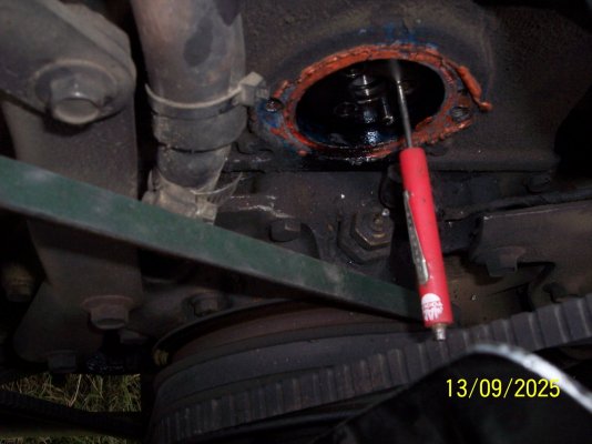

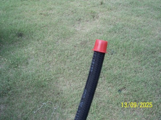

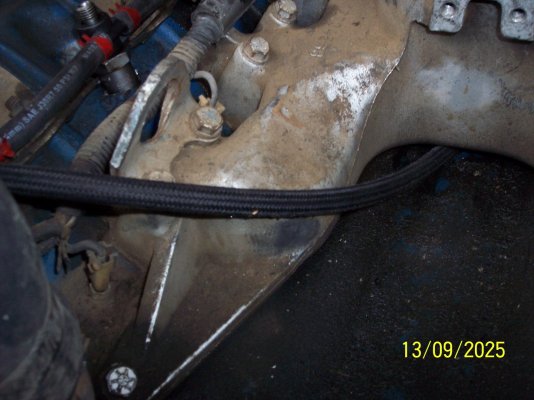

I also have the crossover return line running from #1 injector underneath the intake manifold, back to the T at the rear of the engine. There was both regular and braided fuel line included in the return line kit, but there wasn't enough to do the entire system the way I have it with either type. I compromised by using the regular line for everything except the crossover that runs under the intake. I figured that the braided is probably more abrasion resistant so that's why I used it there. You can see in the picture where the last line had been rubbing on the intake under the new line. If anyone does this type of crossover, I did find a great trick to share. You can take one of the caps from the new injectors, the ones that goes on the upper, threaded part, slide it over the end of the fuel line, and then slide it down the greasy valley pan without having to worry about getting anything inside of the fuel line. I also included a picture of my patented (not really but it sounds good) IP dowel pin alignment tool.
