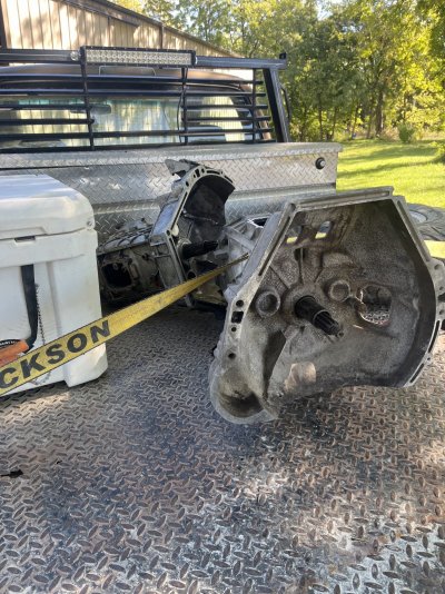

Scored two more 2WD ZF5s. One is missing shift rails, and has a welded up bellhousing. It also needs a new input shaft. Other has a broken bolt hole and slave cylinder mount, but has a slave cylinder mount off of the PTO port. If the welded up case is okay, then I might try and make one good tranny out of these two. Gave $10 a piece, should at least be good for some parts. Have a good 2WD ZF5 from my ‘90, and the 4WD ZF5 tranny in my 86. I’m thinking if/when I swap to Dana 60, might put a 2WD tranny in and a NP205 case, if I can do it without lifting more than 3”. Starting to think I only want a 1” body lift… keep it lower, don’t want the center of gravity too high…

I might also try to put the 300 six motor I have into my 90 F350, if I can find a SBF 2wd T19. Have a good carb head with manifolds and everything, should be able to make something out of it, for a ranch truck of sorts, rather than taking everything apart and getting rid of it, could cobble it together. I have motor mounts too… this could be a thing… doesn’t even have to be done right, just a crappy rig thrown together on very little money… might as well I think…
