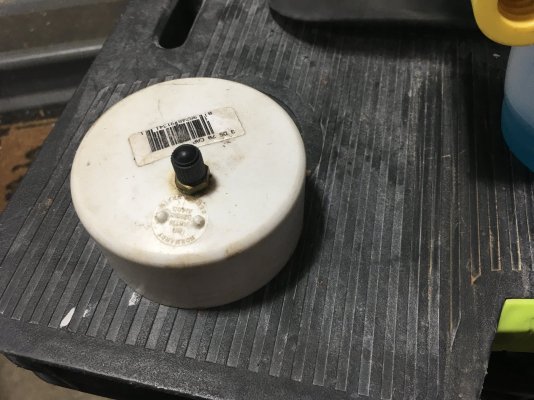

I now know that my hot side has no leaks, but I want to test my cold side. Suspect that I may have an intake leak.
Home-brewed a leak tester. Hoping to try it out tomorrow.

So a trick we use on the big rigs for testing the entire system, take the inlet off the turbo. Hook up some sort of boot to it that you can run compressed air through it. Run at max 5psi through it. It will be a continuous flow of air, since it's not dead heading anywhere, but doing this you can check your entire intake and exhaust for leaks with soapy water.
I’m hoping that is exactly how this will work. I made it to fit my intake elbow; the canister is open on one end and sealed on the other. I’ll use a short piece of hose between the paint gun regulator and the canister.

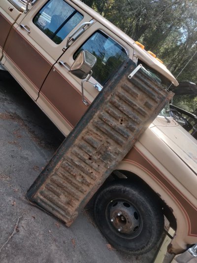

I had to go see my junkyard friend today. I needed him to torch a hole through some steel, but while I was there I noticed this FINE old tailgate. I couldn't just leave it there. He was like, "what are you gonna do with that?" I let him know it would match any truck I brought home.
Would make a great bench too.
