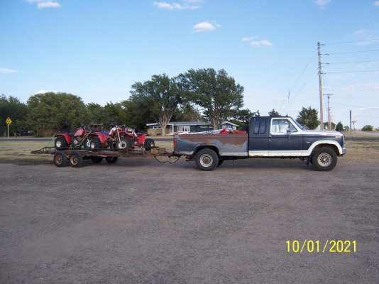

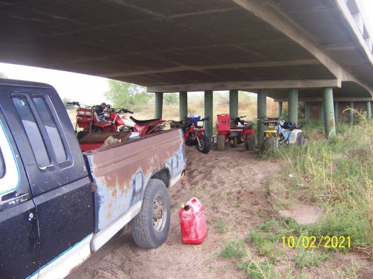

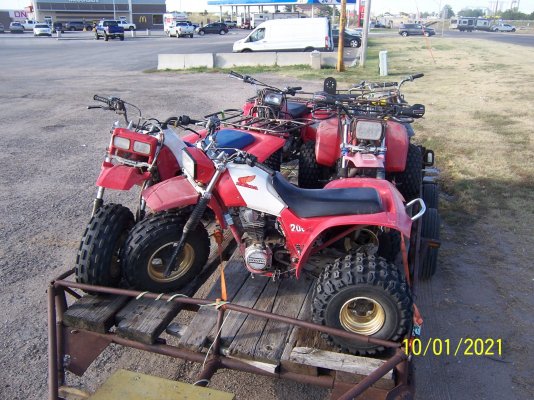

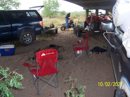

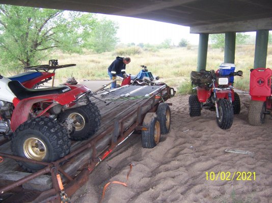

I just got back from a camping/riding trip. We were on a dry river bed. It was pretty fun. I had a little excitement when I got there. I wasn't paying attention and sunk the rear tires of the truck in the sand while pulling underneath this bridge. I couldn't rock it out so I put it in 4X4. Yes! That will do the trick. Wrong! By the time that I stopped trying, I'm sure that the axle was sitting on the sand. We decided that I should unhook the trailer. After that, while I was going back around the front of the truck, I noticed that the passenger's side hub was unlocked. I know that I turned both of them. It was almost dark and I didn't pay much attention when I did it. I must have been driving around with one hub locked in for some reason. After I locked that one back in, I put her in 1st gear, 4 hi. When I stalled the engine, I said "yep. I've got traction now!" I put her in 2nd gear, 4 lo, put the hammer down as I let out on the clutch and she walked right out. I rehooked to the trailer and we continued without any more drama.

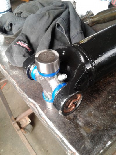

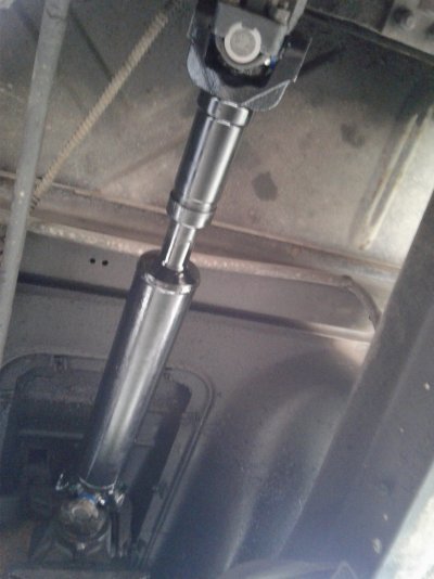

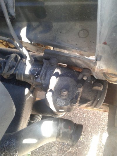

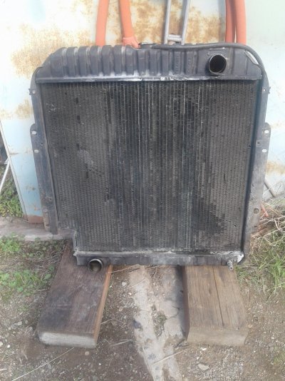

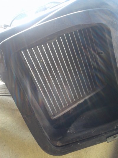

Ths and that, u-joints, intermediate drive shaft, resealdthuper ank on the rad, lowered the heat exchanger for my WVO system, and ordered a new power steering hose, its a 73 steringbox from a Buick Centurian, hose was 15 and change, 15 for shipping. and new heater core

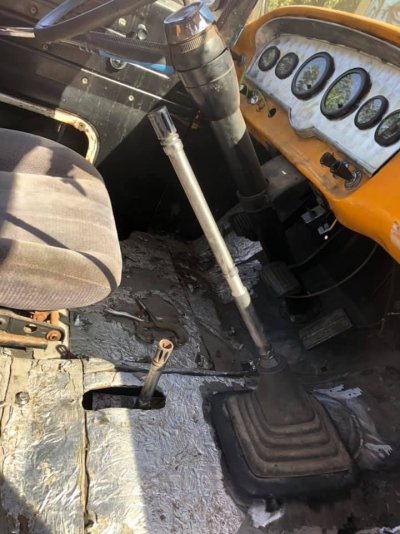

Not much today after work,but I did get the bed pulled off, to get ready for the flatbed. Planning on a new rear fuel tank and gooseneck hitch while it's off then mount the flatbed. The Zf5 is sitting under the truck right now but not in yet. I had to cut the exhaust and trim the firewall a little bit. Should slide right in when I get around to it over the weekend. I am hoping to get this all wrapped up by the end of the month. I don't want to be crawling under the truck in the snow.
