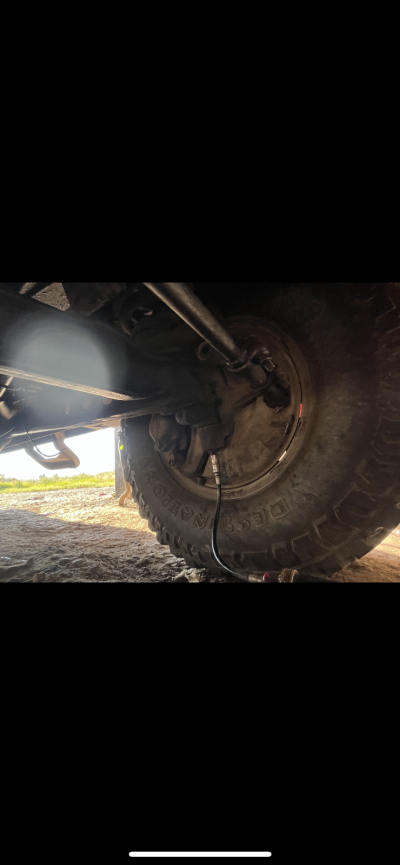

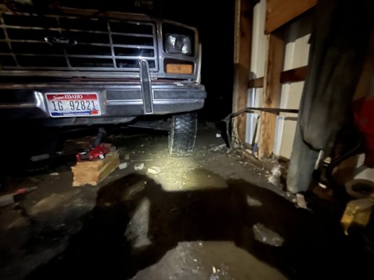

As the title states truck doesn’t return to center worth a hoot
86 f250 2wd twin I beam
New alignment, tires, red head steering gear, and tierods
For the longest time it was like driving a forklift absolutely 0 return to center
Tried to grease the kingpins unsuccessfully many times finally got them to take grease lifting the front off the ground and turning tires which helped a little
I lost the alignment sheet but the tires look like this off the ground if that tells you anything
Excuse the horrible lighting but you can get the jist in this video
I’ve been told in Facebook “it can’t be your kingpins” multiple times as they “can never fail”
But being that getting grease in the kingpins was the only thing that effected the problem makes me thing other wise
What’s the deal here folks?

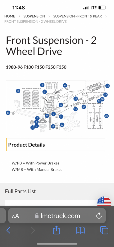

Pretty sure they are kingpins lmc diagrams and parts stores list them as kingpins but I don’t know a whole lot about from axles so could be mistaken
I take it as 100-250 had ball joints and 250HD and 350 had kingpins
