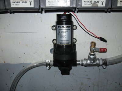

I use this,Flowjet 3000 series pump, I think it was around $70.00 from a local Tractor Supply. takes about 4 minutes to fill up a 5 gallon tank pushing through 3 house filters. 12V operated.

darrin do you have a gravity feed coming to it? my only option is to suck through the top opening in the barrel. Is that actually supposed to spray rig pump or was it back by the actual diesel pumps or do you have a part number..nvm I found it it does say specifically not to run petroleum products through it. how long have you been running it?
