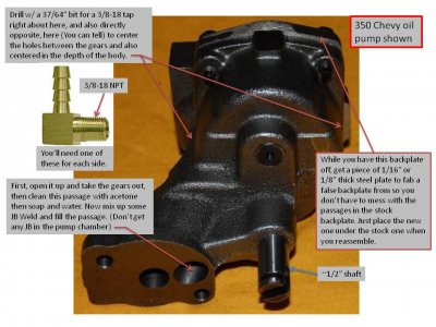

I'll try to find a photo of one tomorrow and show you where to do the mods on it to simplify the set-up. Some J-B Weld, a little piece of 1/16" steel plate and a drill & tap. You can shoot a stream of oil like a fire hose...

yes but I dont really want to invest anything that I cant use for something else just in case this dont work, keep in mind with filter and pumps I am already in this setup about $220 and I dont want to get much further into it in case I have to abort mission.
also what is the need to drill the extra holes, this pump will only be used as a transfer pump to go from tanks to barrels with no filters so why cant one just use the inlet and outlet holes already in the pump. or am I not understanding the oil pump i have never seen a sbc oil pump so that might be a stupid question....

The Chevy oil pump is drilled and tapped for fittings on the inlet and outlet. The stock pump has smooth holes. No way to attach hoses to it.
Not sure I understand that. Are you saying the aftermarket sbc oil pumps are slick and the one from chevy is tapped or vice versa?

The Chevy Oil Pumps are smooth. You need to tap them so you can screw fittings into them.

Hey 'Neck,
Sorry it took so long... I actually had to work at work today... The nerve of some people.LOL Anyway, this will help with the understanding. Drilling and tapping the pump body only takes a couple minutes and makes things a lot easier to set up.
