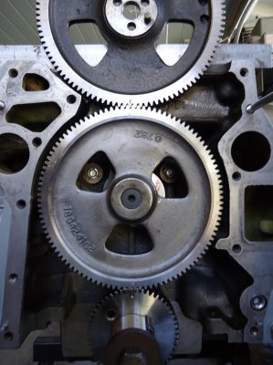

So I pulled the front cover and oil pan. Can someone confirm if this is the desirable cam gear.

The improved cam gear does not have threaded holes for a puller, and has a cast lug on the back to balance the fuel pump lobe.
One of my big pictures: Rt click on pic and select view image.
Thanks Tom! Damn. Okay, I'll ship that cam gear off and roll the dice. Maybe I'll get a good one back.
