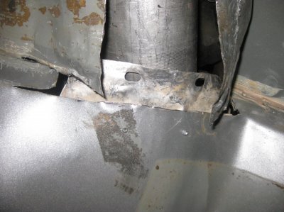

Finally got some garage time. Pulled the dashboard out.
Pulled the heater box out.
Got the heat gun out and pulled back the sound deadener. Spent way too much time looking for my scrapers. :mad: I swear there are gremlins in my garage that hide tools. :rolleyes:
Hope my fellow boobs are enjoying the Christmas season!
bbjordan
Snow Monkey
Feb 24, 2011
1,427
399
Ashern Manitoba
Don we now our garage apparel...

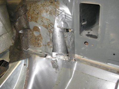

Measured twice. Well, more like guesstimeasured...
Scalpel...
As you can see, I still needed to open it up more. Notice the turbo still has to move left about an inch.
Mounted! It is possible to put a 4" down pipe in an OBS ... with a little effort. :rolleyes:
Close up view:
A view from inside. It is still a little tight at the bottom, but I pried it out after the pic.
It looks like there is still enough room to get the heater box back in. Woot! LOL
A couple of views from underneath:
So far, so good. I´ll have to modify the dash brace that mounts where I cut it open, but that´s minor. No complaints from the patient...yet.

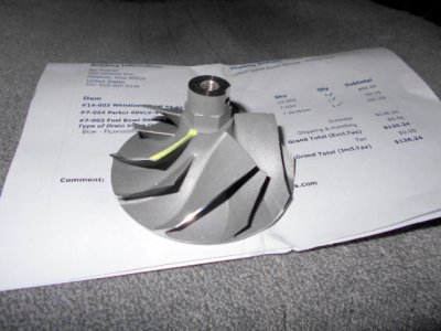

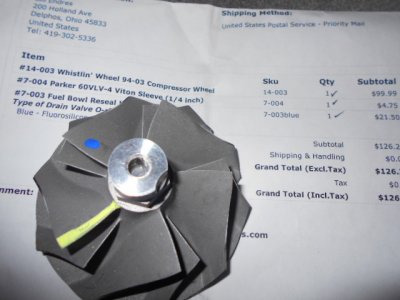

Here is a pic of the WW1. Bought it a year or so ago $100, haven't installed it yet, so don't know if it will make any difference. WW2 is $200 +. FTS.
Haven't been following your thread, but read it all the way thru.
Don't know why you went to a 4" down pipe, my 99.5 -- 3.5" is plenty big enough with straight pipe.
