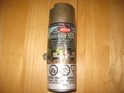

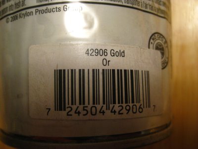

Where did you get the Gold paint? And could you post the part number?

Krylon metallic finish gold paint
I picked it up at Canadian Tire. Here you go:
I've heard others dis'ing Krylon paint, but I've always had good results with it. There are two coats of paint on the parts.

thats cadilliac gold!;Sweet
if you clear coated them after paint, they would really pop.
also helps in longevity.
its not really the paint, its the prep and throughness that makes people hate on krylon.
they take greasy nasty stuff and expect them to come out perfect ;Really

You're right on the prep work. Varsol tank first. Dried them with the air hose, then spray them down with brake cleaner. Sanded them down with 100 grit sandpaper. Then washed them with soapy water and rinsed them with HOT water so it would evaporate quickly. Fresh Nitrile gloves to handle them, and then 2 coats of paint. One coat per day.

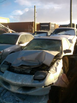

We had a winter storm here on Tuesday. My son and his girlfriend were coming back from the farm at night during the blizzard. He was driving the cube van, she was driving a 1999 Sunfire. She hit black ice on the highway and went thu the median cable barrier. :eek:
Result:
She managed to walk away without a scratch! :angel:
Dealing with that took up some time. I know, excuses, excuses...:rolleyes:
