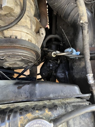

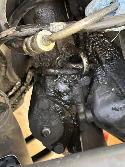

my power steering has always had a persistent drip so i replaced the return line and it slowed it down but still leaked so i bought a high pressure line i was unable to get it off so i just put the old one back in now when ever i start the truck it just drains the power steering fluid
im just going to replace the pump and all the lines while I'm there and its original as far as i can tell
what are all the lines besides return and high pressure? i know that there is a cooler but that is all metal and cant leak correct? Hard for me to tell as there is about an 1/8” of grease minimum everywhere

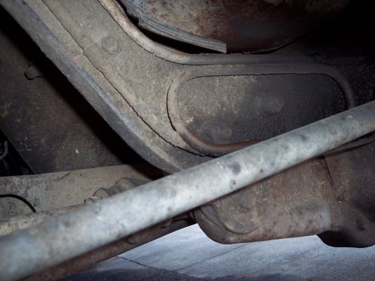

I don't know about your RV, but your F250 should have one. The type of cooler these trucks use is the metal lines that run in a loop on the front side of your engine cross member. It's not a fin type of cooler, but the long metal lines do shed heat. Here's the one on my 85 F250.
