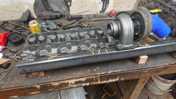

I ask someone to grab 2-1/2inx3/16inx4ft tube when at the metal shop, what I got back was 1/4 wall.
It is a usable size sinice can be ported to size.
Random cheap 38mm input/ 35mm output wastgates that claimed 10/20/30 psi, is what I got and dont know if right size. This one peaked my interest with its inconel seat and valve.
I see something with this tube in its about correct size for the ports, It would just need the edge filled. As for bolting it down, what about plug holes for cap screew access?
Im not sure if not having runner to the log will cause issues with flow but is close to equal volume of the oem. Thinking some more on that ideal, dont see having the bolt inside would be good since have a chance to come lose and wreck a turbo. Running tube through for bolts to give compression on the head face would give restriction of flow. Just holes for bolts would not be as bad but is the 1/4 wall adequate to not deform on the head face surface?

Looking at this further, there is further thought brewing on the subject. Say this section of the tube is the passenger side exhaust manifold log, and extra being the driver side. This would be enough material for the base structure, would need extra for the up pies. The old manifold gives example for a 1/4in plate to be welded to the tube, this is the pace to bolt to the head. Then take some 2in dom to fill in what would be the open areas off the ports going into the log. Thinking could somewhat mimic the oem ones, as apposed to trying to build off them.

More cuts were made on the jig, made end caps and had someone weld them.
Next is trying to make holes, a hole saw failed but can make imprint. I ended up using a cut off and finishing with a burr.
Now have the tubes fitted to one manifold log.
Now need to make a plate and this one is ready for welding.
