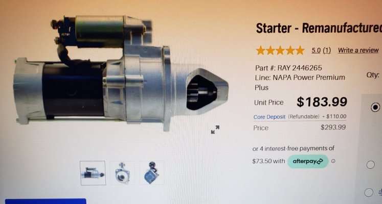

I'll probably get the Napa Mitsubishi reman which I believe is what my OE is or, is it Prestolite?

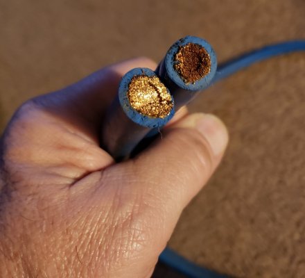

And just mentioning, I have some 3/8 - 7/16 blue welding cable, maybe a little over kill but maybe it would make for good battery cable's???

That's certainly not a bad price on the Napa starter. I think you'd have to go a lot bigger than that welding cable to reach overkill for our battery cables. Ig you want to see underkill, check out the factory battery cables on a GM 6.2/6.5. Those don't look like they're much bigger than gasoline engine battery cables.

Fingers crossed, it goes in tomorrow.
I would have preferred the Promaster 9050 but with snow tomorrow I couldn't wait.
*same exact rebuild starter from Nappa 'BB'' $189.00 lifetime warranty.
I got this one (BBB/vision oe) from another parts house (my discount) $100 but a one year warranty.
