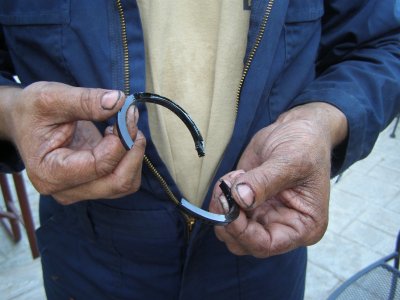

This is what stupid is as stupid does looks like.
I have my Amsoil bybass block mounted behind the front bumper and below the drivers side headlight.
In a furry of finishing projects before we headed out, I did an evening oil change on Goldie and didn't check to see if the old oil filter gasket came off with the primary filter.
Well she made it 543 miles before she decided to empty all 12 qts of fresh oil all over the campground roads.:eek:
Tis a good thing it happened there instead of on the highway on the way there, so she didn't sustain any bearing damage.
I gotta thank Chris for helping get most of the oil soaked up off the drive so I didn't get yelled at by the manager, who did question me as to what happened, since the trail of oil did lead right to my lot.;Sweet

Man.... that sucks!!!!!! That always happens at the worst time.... and althought it happen in the best place, it is still the worst time. Did you have trouble findint extra oil..... I am sure the "spare jug" behind the seat would have topped that off......

I had a gallon of oil and so did the Agne crew. After we went to the waterpark, we stopped by Advanced and I picked up 2 more gallons and a FL1995 filter and just bypassed the system.
