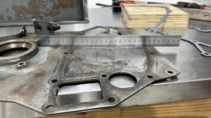

Also noticed the front plate had a bulge where the water pump impeller is:
After some time in the press, it got it almost eliminated:
The plate appears to be 1/8" think, so I'm not sure how that happened in the first place? Anyway, hopefully that small amount of variance still left won't cause any issues, being that the plate will be sandwiched between the block and and water pump housing.
