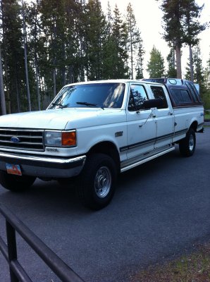

Hello everyone,
My name is Jarred and I bought my first ever IDI. I am really happy with the truck and the fact that it is mechanically controlled versus modern electronics.
A little bit about the truck:
'91 F350 XLT Lariat 4 door CC
ATS aftermarket Turbo system (installed in '99)
Perma-cool Oil cooler
Trans cooler and filter
Hummer glow plug controller with manual switch in cab
Rebuilt Transmission
The PO states he had this truck for 10 years and that he hadn't rolled the OD yet so if that is true it had 90,000 miles on it when I bought it for $3,000.
Since I bought it I have tinted the windows, added a shell and put 4,400 miles on it. I really needed a truck for our business as we travel all over selling Celtic themed goods at Highland games. So far it's been wonderful and I have been lurking through this forum for awhile and really finding all of you guys very knowledgeable.
Everything has been running great until I did a steep hill climb and the engine pegged the temp sensor and the engine light came on. This was at the top of the hill and I pulled onto the frontage road where we coasted for a little while until the engine cooled off. Since then I've been watching the temp and it gets up there but nothing like before. The day was high 90's, AC blowing, camping gear and dogs in the bed.
