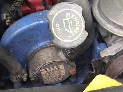

Is your CDR like this below?
374

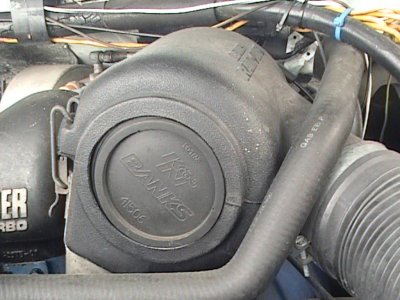

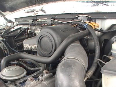

If I had to bet, I'd say that hose kinked on you and that's what blew out your seals. You can't use cheap vinyl hose, and heater hose is probably too small. I forget what I use, but it's black rubber and looks like radiator hose. It fits on the Banks adapter.
You can see it here. It's zip tied to the heater hose bracket on the alternator.
In this view it is the hose going over the top radiator hose.
Here you can see it coming off the Banks adapter.
