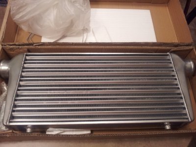

Agreed! For $101 shipped to my door, and well packaged at that, this is a heckuva deal
