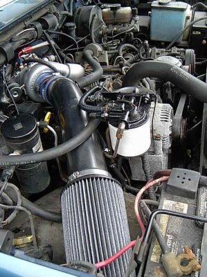

Im running a Racor R45S in place of my factory 6.9 water separator. Its a 2 micron filter separator. Don't know if that's absolute, but probably not. And that's ahead of my stock filter which I use either Baldwin or Fleetgaurd. At this point, its as fine of filtration as Ive been able to figure out.
Actually thats backwards the finer filter should be lasts, but I did the same thing on my 87 6.9 with a racor 200sm turbine style separator. The r45s is the filter gasket and threads the same as the 6.9 filter? If you read the info I posted It says that Racor ratings is 98% for 2 micron filters but it doesn't say absolute or nominal. I e mailed them and I will report back

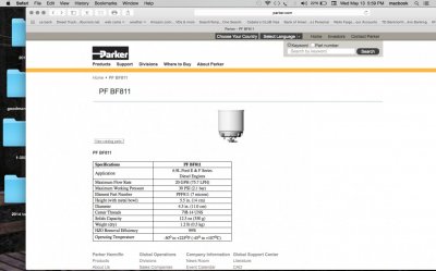

This is why I'm going to do this mod next. You can run a longer filter such as the racor s3225s 2 micron.

Racor rep on the phone said there s3225s is 2 micron at 98% nominal. This is a longer filter that would require relocation of filter head. The pff829b is a direct replacment for the 7.3 filter that uses the oem bowl he said is 7 microns @ 98% nominal.
I found today that a Donaldson filter P551055 is a direct replacement and according to their web site is 4 micron at 99%. So this maybe the best filter we can buy as a direct replacement.
https://dynamic.donaldson.com/WebStore/search/item_detail.html?section=10166&item=948138
this place has them for $20 each but you have to buy 12
http://filterspro.com/detail.cfm?part=2739472
If you buy it as a kit with clear bowl and sensor port you can get them here for $24 part number p559108
http://www.filterspro.com/detail.cfm?part=2142957

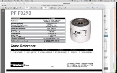

Here are the stock racor replacement specs for a 7.3 and 6.9. Two filters, one before the lift pump say 30 micron then a final at 2 micron, is the best setup, but I don't want a filter underneath truck. I ordered a Donaldson P559108 today and will post back how it fits. I'm thinking it is the best we can get without changing lines, filter heads, brackets etc. If their ratings are correct at 4 microns @99% that way more than other filters and more than someone posted was required for the ip pump as per manufacture. 6.9 is 7/8 threads 7.3 is 1"
