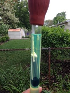

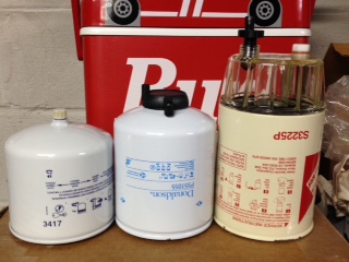

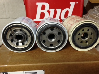

I installed P551055 Donaldson today. In the first picture I have a Napa 3417, Donaldson P551055, and a Racor S3225P side by side. As you can see the Donaldson is longer than the Napa. It is the absolute longest filter I could get on without moving filter head. I was just able to get filter wrench out. My wrench is 1'' thick so use a strap wrench or a thinner one. If you have an electric pump and don't pre-fill filter this wont be an issue because the drain valve can be loosened, which would of allowed me to get it out easier, but I pre-filled so I could not do that.
In the second picture the Donaldson on the left has a lip around the center hole allowing you to pre-fill it easily. You can't see it in this pictures but the Donaldson and Racor have better seals inside the center hole than the Napa.
So all went well and my pump is getting cleaner fuel and the filter is only $25 saving me $15 a filter.
I also did a cetane test (third picture, don't know why it turned but was correct on my computer) on my fuel. I cant find the conversion chart for the cetane tester. Does anyone have one?
The SG type cetane testers are not accurate for LSD or ULSD. I have one too... have since the early '90s. In the course of a story on fuels and how cetane effect perfomrance, which was about the time the LSD came out in the late '90s, I found out from the Stanadyne Power Formula chemist that the SG tester could not reliably rate LSD. We went out to about a dozen fuel stations in the Denver area to compare a tester they had to a SG tester and sure enough... It's been decades since then and I haven't followed up, but I tell you this so you won't go down the wrong road. If you find out there is now a calibration for ULSD for a SG tester, please let me know.
