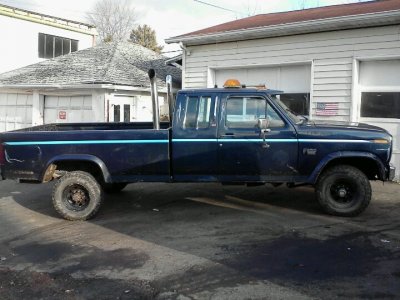

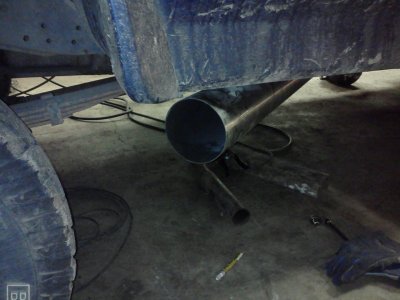

i drilled 1/8th in drain holes in all the low spots on my 250 and even if it was humid out it'd blow the condesation out of the pipes, a few cold starts and my white truck was grey. cookoo i took them off the '85 i just got and used one as the exhaust under it.
pic with stacks, then the exhaust with the turbo, it goes 3" downpipe, the 4" stack then a 2 foot pitce of 5" ;Sweet
