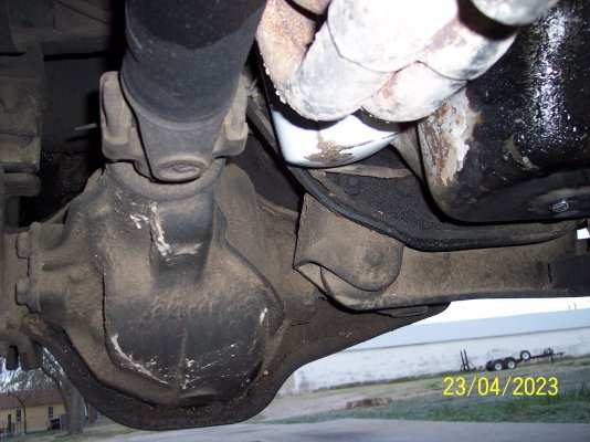

It wasn't installation clearance that bothered me.... It was the prospect of the pinion smashing it on suspension travel.
That's one that I hadn't thought of before. The way this looks to me, I don't think that could happen, but in extreme off road situations, I supposed that it might be able to happen. Here's the bottom of the one on my truck. There seems to be enough clearance to me.

Doh... that's a different view than I remember. :oops: I do know we had a whole case of PSD filters at one point, and we were too nervous to use them on one of the IDI's due to length. Dang memory... Oh well
