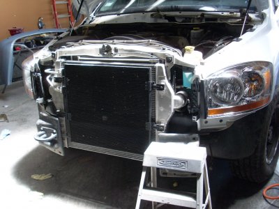

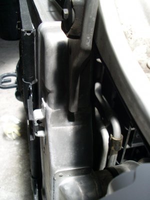

hey Tim-
check this bad boy out;Sweet

hey Tim-
Holy Mary, that's quite a bit of cooling ;Sweet I presume the bumper was damaged/getting repaired or replaced...did any of the exchangers get damaged in the hit? If so, I feel bad for whoever has to pay that bill :shocked: seems like those exchangers hang quite low...I imagine there's a fair amount of potential for damage on the lower parts. Certainly explains the need for bumper cut-outs :D
actually the hit was hood/fender/driver's headlight. A garbage packer backed into him:eek: he was lucky that was the only damage.
here's the comparo's between the two.....
'06 dodge....27&9/16x24&5/16x1&7/8
'99 f350SD...29&5/16x17&5/8x1&7/8
