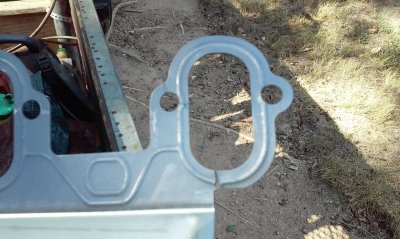

does anyone see a problem with installing this manifold gasket?---Rob

i sure in the hell do.
its garbage.
you may get it to seal, seeing only air is seen in this part, but i would never even think of using it.
681
Ideally I would not use it but if it was the last one on earth and I needed to drive the truck then yes.. I would use it. In addition to this if you do not have a turbo on this engine I would run it but seal this area well with rtv. I feel a turbo may blow out this area no matter what way you seal it. If you are VERY good with tig welding you might be able to weld this up too. Only problem with tig welding it is you have nothing to test weld on.
342

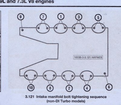

Oh, come on Gary, how ya gonna Mig weld something covered with gasket material. In the first place, the gasket is recommended to be a one time use only. JB weld may do it, if it's assembled before the JB set's up. Even the torque sequence and bolt torque is important. Bolt torque--40-45 Ft lbs. Final torque sequence, start at #9 and go clockwise to #10.

Gees Bill you caught me big time there. Actually I "could" tig that well enough to work but would I take the chance of it leaking.. Well that depends on where I can and what I need to get home safely. Our engines can run without any intake but they sure will get dirty and oily under the hood.
