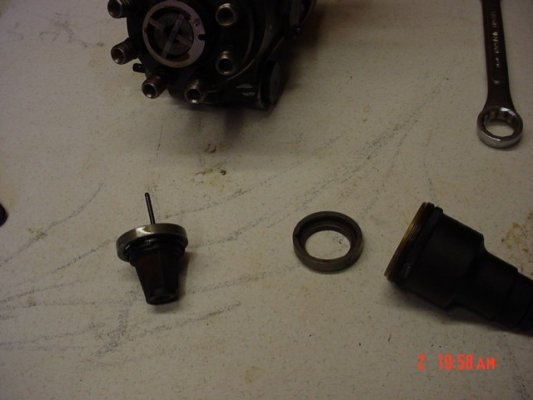

Take off the feed line and that next piece has two flats on it . It may stick out past needing to remove any lines . It unscrews and the filter and a few parts come out as pictured . Dont go any further ! goes back the way it comes apart .
Awesome thank you for the picture!
