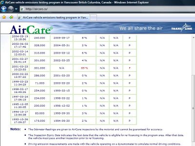

I have not had the Truck timed with a meter but would it be THAT drastic of a difference?...
I am very curious about timing.
Yes it will.
I had to replace a set of heads a number of years ago. I put it all back together and it was running great. I didn't worry about the timing because it was running fine and sounded good enough by ear. It came time for the yearly opacity test and I just ran it until it was good and warm, like every other year,and got in the lineup. FAILED BADLY. Our test is a 'road course' where they run at various RPMs on a dyno and have a couple of full throttle runs to simulate freeway on ramps, hills etc.
Here are the results for a number of different years with the 'un-timed' one being run on 03/23/2001 (left coumn). The ONLY thing that was changed on the truck was the timing (I can't remember the pre/post #s) but when it was tested on 03/27/2001 the difference was amazing.
Something to think about.
