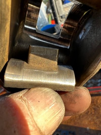

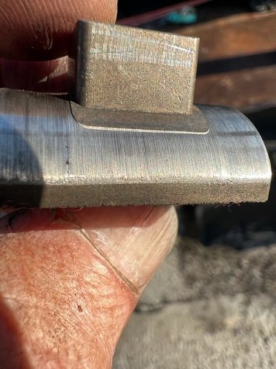

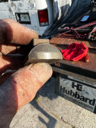

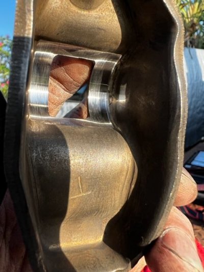

IDIBRONCO, I bolted the two rockers back and cranked it up. It took about 40 seconds for the oil to start coming out of the push rod tubes, all of them! I guess it takes time but the oil came out of one middle tubes first then the 2 next to the firewall then the front two last. Maybe it isn't so bad but have definite wear on the curved part that goes on top of the rocker that the bolt goes through. I don't know what that is called, maybe a rocker retainer or something. Just an old engine. thanks for your feed back.
Mike Duke
Duke57
Jul 30, 2017
247
68
Florida
here are what the rockers and retainers looked like
