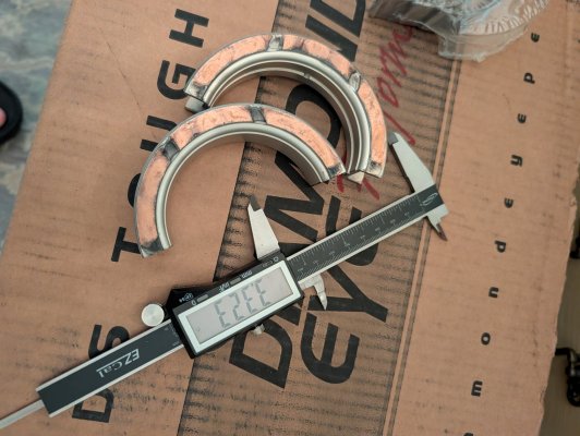

I happen to be working on the engine today. So I got the measurements you and I both were wondering about. Looks like these pass the test. I've got a dial bore gauge so I am definitely going to test fit all bearing fit ups. Appreciate the effort in this. My old bearings actually look just fine. Could of just left them alone, but figured since I'm in there, just give the crank a quick polish, replace the bearings and go.
