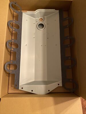

I just got off the phone with Olson`s Gaskets in the link I posted above.
1-360--871-1207 talked to Richard, real nice guy. They are a small
business and make all type of obsolete gaskets, and ship around the
world.
One set is 4 paper gaskets, goes on each side so you can use your old VP.
$75 a set, Iam having him do an over night ship UPS.

Yesterday got the Gaskets for the Valley Pan from Olson`s.
Called on Monday and paid for next day delivery, got them
yesterday around 1pm by UPS. So next day & 1/2 delivery.
Well made, you get 4, one for each side.
Valley pan is rusty but not rusted through, scrubbed washed
de oil`d it, and threw on some POR. Should be dry and ready
to throw on.
