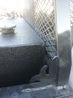

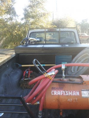

Greendiesel, here's a pic I just took of mine. I just had my tank and toolbox sprayed w/ bedliner and lovin it. It's a bit shiny since it was just done, I'll like it more when its dulled out some

That is nice looking with the bedliner, I would have rather had a black tank but i picked this up for a good price.
I decided not to go with the pump from the craigslist add, It looked like a fillrite knock-off so its prob a pretty good pump but I went ahead and bit the bullet for the 15GPM GPI pump from Tractor Supply, with 2 year warranty and rebuild kits readily availiable
Here are some pics for ya's, new headache rack and x-fer tank woo-hoo ;Sweet

looks great! I love headache racks!
